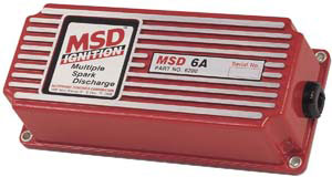

Ryktene stilsier bra, men hva er MSD???
_______
#4855 Svein54
Svein54
  • 1201 Innlegg:
Posted 18 December 2008 - 08:35
Multiple spark, capacitive discharge ignition control
Base model, CD, multiple sparking ignition control
Multiple sparks for 20 degrees of crankshaft rotation
Works on 12 - 18 volt electrical systems
Accepts breaker points, amplifier and magnetic pickup trigger inputs
470 primary voltage output to coil
110 millijoules per spark up to 15,000 RPM
No programming loops, works on 4, 6 or 8-cylinder engines
CARB E.O.
The MSD 6A is the base model of the capacitive multiple spark discharge 6 Series design. Whether you have a powerful street machine, hard working truck or trick street rod, the powerful multiple sparks of the MSD 6A will ensure complete combustion. Benefits such as quicker ETs, easier starting, reduced plug fouling, more power and even increased fuel economy can be expected with the 6A's high energy multiple sparks. Like all of the MSD 6 Series Ignitions, the 6A will work with virtually any vehicle as long as it has a 12-18 volt electrical system. It can be triggered using breaker points, a magnetic pick-up or the output of an electronic amplifier. All necessary parts and wiring instructions are included (OBD II legal on '03 and older vehicles).
Her har du svaret Sven. Dette fungerer helt perfekt og fikk testet bilen i går og den er mye kjappere på gassen og man merker forskjell med en gang. smile.gif
Han ledningsdoktoren fra Lillehammer/Trondheim gir seg ikke før det virker. biggrin.gif :
http://www.msdigniti...om/default.aspx
Edited by Svein54, 18 December 2008 - 08:36.

Posted 18 December 2008 - 10:24
http://www.msdvideos....php?reset=true
Er dette noe jeg og må ha?
Kan jeg hive det eletriske på motoren og da??? MSD altså.... Anbefaler du det???
